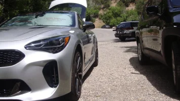

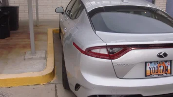

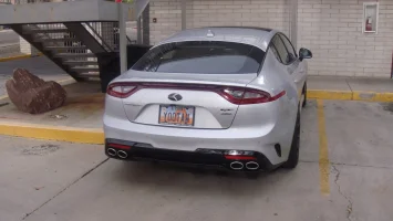

I’ve had them on for 2 months no rubbing at all. Stock Staggered wheels
Pic for reference

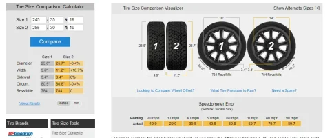

Well, I feel a little bit gobsmacked. Why are others saying 255 is too wide for the front? And what about sidewall bulge? Your rims are kind of narrow for that wide of tires.
Wanted to do 285 in the rear but Discount wouldn’t do it as they said the wheels was to narrow..I showed them 17 photos of cars on stock wheels with 285s but they said they had to go with what the computer said due to reliability issues
You wanted 285s on 8.5 wide rims?? o_O
