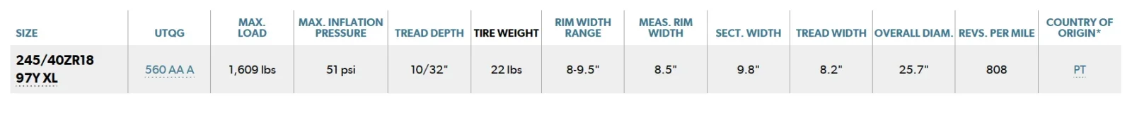

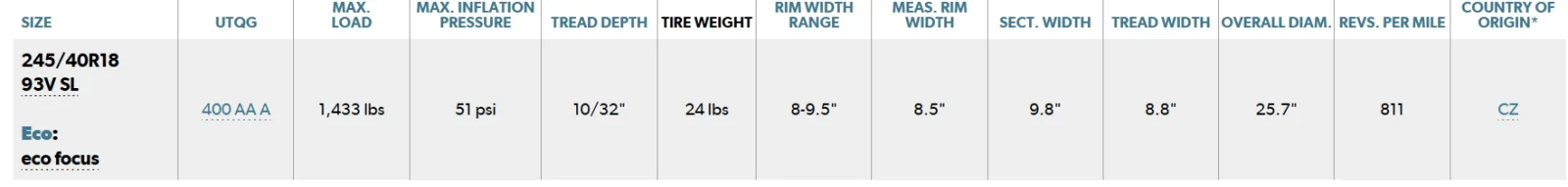

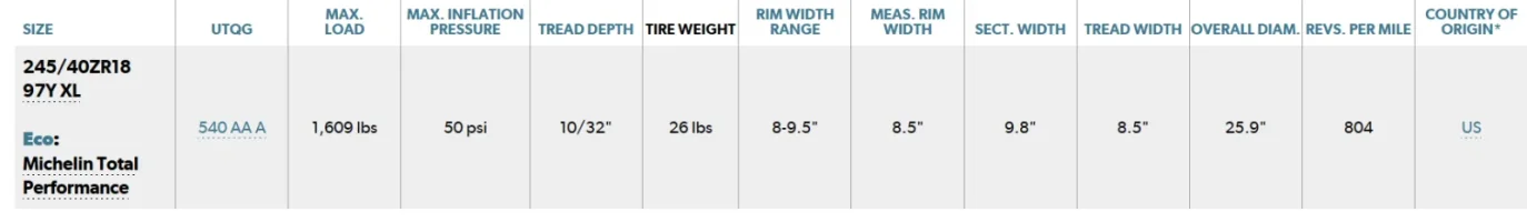

My own take on this is I'd be more concerned about traction differences L/R or F/R. Not something apparent under normal driving, but may be so under heavy cornering or driving in the rain.
I can see a tire (any tire) flexing enough to blow out if it's under inflated. Running different diameter tires on the same axle should just result in different speeds within the diff (front or rear) (in addition to handling/traction issues). This may not be good if you got a lsd. It'd be like driving in circles all the time (for one axle).
Something else to consider, same size tires may differ in diameter between models even of the same mfg. It's important to look at either tire diameter or revs/mi to get a more accurate size indicator.
Example, 245/40/18
conty dws 06+ $ 196
Mich PS AS4 $232
Conty contiprocontact $248.60
Note on the first and last, overall diameter is the same at 25.7" but revs/mi differ slightly. Judging by the above, I'd sat the PS AS4 has the larger overall diameter.
ymmv
