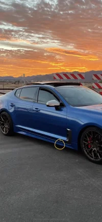

Hey all. I had my '21 Stinger in for a state inspection and 12,000 mile check up at my local dealer last Monday (5/23). Today I just noticed some damage on/under the rocker panel under the front passenger door just behind the front wheel.
I can’t get under the car but it drove normal this morning with no error codes, and the exhaust sounds normal, so I don’t think it was converter theft or anything malicious.
The dent on the bottom is around the size of a quarter and has a pretty definitive hexagon shape on one side. Thinking the dealer messed up lifting it or maybe left a socket driver or something on the lift and started raising it. I'm not very mechanically inclined but I asked some of my gearhead buddies and they came to the same conclusion.
I'm not too upset as mistakes can happen and this is fixable, but by nature I'm just assuming the dealership will refuse to own it and blame it on something else, so I want to be prepared for the discussion.
It's basically impossible this was any type of road damage from driving, and I also highly doubt someone tried to steal my converters. I live in PA where there are a million trucks and SUVs. The Stinger seems like a more difficult converter theft target, plus I'd expect a much larger imprint from a standard hand floor jack. Plus there are no other signs of any malicious intent.
I would appreciate any input on this, as well as tips for how to approach the dealership about this. It's possible they will own it and take care of it for me, but I want to be prepared if they push back.

That was caused by improperly raising the car. It's happened before several times on here. Just be straight up, that the damage wasn't there before you brought your car in.

Yep thats lift damage. Been there got that, still do. My dealers service Mgr. and i came to an agreement on a few things so i was "lucky". Definitely go back and bitch about it. The techs should definitely be put on notice. And like @nhcowboy28 said fully inspect before and after.

Stopped by the dealership this morning. Service manager took a few photos and told me they'd order a new panel, have the body shape paint it, and call me to come in when it is ready to be installed. They didn't even float the idea that the damage could have been caused by something else.
So while I'm annoyed that this happened, the dealer is making things easy on me which I appreciate.
