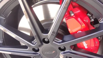

I run a front rim size of 19x8.5 5x114.30 40; so, the offset is 40 but I still don't know what the 5x114.30 refers to. Guess it doesn't matter? The OE front tire of 225/40 clears well; the inside of the rim barely clears the brake caliper.

It means, "talk to us and give us your stats, and we'll set you up properly." I went through a local tire and wheel pro shop and let them do all the work. It worked out perfectly. They selected options from their catalogues that suited my desire for black wheels and the rather conservative styling that appeals to me; and I chose the TSW "Watkins": from that point, the pros found the exact wheels that, in their judgment, would suit the Stinger best. :thumbup:
