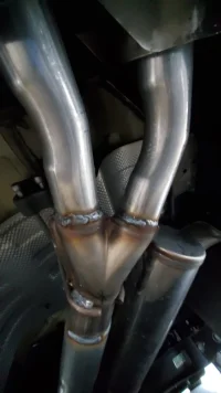

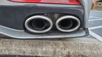

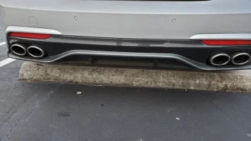

Exhaust tips are a must with aftermarket exhaust in the stinger IMHO. Even with my 2.0 aftermarket exhaust drone was a problem. It's really more like a reverberation than drone, the hatchback design seems to really intensify any noise by the exhaust that's not able to escape past the bumper trim of the car back into the cabin and it reverberates like a tuba. My exhaust shop tried Vibrant Resonators saying it works 90% of the time to reduce drone, but it actually made it worse. He ended up cutting off the exhaust tail pipe at the Y joint and welding in longer tail pipes to extend close to the edge of the factory tips and the difference in interior noise is day and night. Previously my daughter said her head felt like it was going to explode, and now she says it's perfectly fine.
