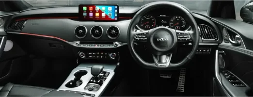

Does the GT-Line have the T-Shifter?
Pray for a glitch, because this could be a sign of imminent failure (ie transmission slip)
I think the gt-line isnt electronic shifter, its linkage I think.
It probably wasnt all the way in reverse.
The 2022 GT Line is the top of the range 4cyl so it would have the electronic shift same as the 6 cyl GT
Though there is only Drive, Neutral and Reverse, the shifter actually has four positions....there is no Park position as that is set with a button.
Depending on how the shifter is used, position 2 can be either Drive or Neutral whilst position 3 can be either Reverse or Neutral.
Position 2 and 3 however cannot be both neutral at the same time. If position 2 is Drive position 3 will be neutral. If position 3 is Reverse position 2 will be neutral.
Depending on whether the vehicle was in Position 2 (Drive) or Position 3 (Reverse) when it was switched off will determine where neutral is when you turn it back on.
Scenario 1
If vehicle was in Position 2 (Drive) when switched off. On starting......
Pull shifter back to Spring position 1 to select Drive. Selector returns to Position 2. Car is now in Drive. Push shifter to position 3. Car is now in Neutral. Push shifter to Spring position 4 (Reverse). Selector returns to position 3. Car is now in Reverse. Neutral will now be position 2.
If you want to go straight to reverse, push the shifter forward to position 3. Car is now in Reverse. There is no need to go to Spring Position 4 to select reverse.
Scenario 2
If vehicle was in Position 3 (Reverse) when switched off. On starting.....
Push shifter to Spring Position 4 to select Reverse. Selector returns to position 3. Car is now in Reverse. Pull shifter back to position 2. Car is now in neutral. Pull shifter back to Spring Position 1 (Drive). Selector returns to Position 2. Car is now in Drive. Neutral will now be in position 3.
If vehicle was in Position 3 (Reverse) when switched off. On starting......
If you want to go straight to Drive, pull the shifter back to position 2. Car is now in Drive. There is no need to go to Spring Position 1 to select Drive.
Scenario 3
Car is running and in neutral in position 2. Push shifter to position 3. Car is now in reverse. No need to go to spring position 4 to select reverse
Scenario 4.
Car is running and already in neutral in position 3. Pull shifter back to position 2. Car is now in Drive. No need to go to spring position 1 to select Drive.
So depending whether you select Drive first or Reverse first will determine if neutral is now in position 2 or position 3.
To confuse this even more as I was working this out, the vehicle does not like to be turned off whilst in Neutral. A warning appears telling you to restart the vehicle.
I dare suggest that to the original poster the selector at some point was in Neutral...I have done this myself.
I test drove a '22 GT-Line and it had the "T" shifter. The only trim throughout the Stinger's life that has "shift by wire" is the top trim, the GT2 in the US, "Limited" in Canada, and the only trim in Aus. Do I have that right? Did you guys ever have the "T" shifter?

The top trim in Australia is
GT- Six cylinder 3.3 TT
GT- Line four cylinder 2.0L Single turbo
The base trim in Australia is
330S - Six Cylinder 3.3 TT (typically used by Police in some states)
200S - Four Cylinder 2.0L single turbo
All are shift by wire
I don't know what earlier year there was a T shifter but 2022 had shift by wire all models
