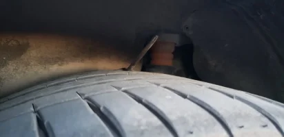

The rear driver side tire of my '21 Stinger got punctured by a screwdriver that was on the road. It went through the upper sidewall and through the thread. I got my Stinger a month ago (Feb 6th) and have driven it for 2300KMs (1430 miles). I'm not sure how much wear there is already on the tires so I'm curious if replacing only one tire is a bad idea. Could this possibly damage the AWD system overtime?
Here's a photo. Also, I can't seem to find the exact same tire online in my area.

Holy crap!? Lol!!! That is a pic and a half. Well, at least you survived! :p
