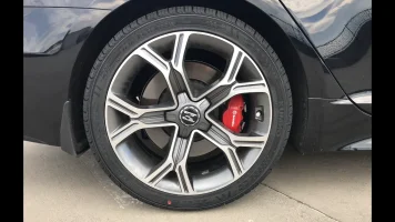

Has anyone put a larger tire on the rear on stock wheels, and if so what size?
Do the 275/35's fit on stock factory wheel's?
I‘ve had 275/30/19 on my rear OE wheels for a month while my aftermarket wheels were recoated without any issues.
FYI, you can do front tyres 235/40/16 & rear tyres 265/35/19 on OE wheels no issue at all.
Thank you for the response and information. Have a blessed evening. Art
That's actually not safe. The widest tire you should put on a 8.5" wheel is 255 max. You may get away with going higher or you may suddenly get a bow out. To OP, don't put a 275 tire on OEM 8.5 wheel. It's simply not a safe practice. It's akin to leaving a car raised on a jack while working underneath. It may work but it way also come crashing down on you.
