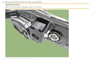

Has anyone noticed this yet within the service guide?
I wonder how much this weighs and what effect it will have on the suspension.
Anyone remove this?
Can't tell from the pic but if it's small-ish it is prolly just a vibration damper, won't save weight, and NVH will go up if you remove it...
I removed that piece. About 5lbs. Didn't notice any difference in noise
where is that located?
can you get too it without jacking up the car? or taking anything else off?
I doubt, you can get to it without jacking the rear up. No need to remove anything to get to it. It is boltedvto subframe with 2 bolts

Dampers like this are often there for reasons like tuning out frame vibrations and metal fatigue. An extreme example is airplane flight control flutter (videos available on youtube). This is also what is most likely happening with the brake rotors that people keep warping, but not enough people have made kia buy back the vehicle to force a change post-design and testing in that area. So in short, removing this is probably a bad idea, it's there for a reason. They wouldn't arbitrarily put weight somewhere just for funsies. Some people may confuse "damper" with specific applications, like sound deadening, bump absorption, but usually weights like these are used to change the frequency of the part, so that it no longer responds in a resonant way, at the same frequency as inputs that would cause those inputs to then amplify and ultimately lead to possible failure or structural compromise. In this sense, it's still a "damper", just not doing exactly what a shock absorber does.
I agree with you. It is there for a reason. And before removing it, i knew, i might have to put it back. But i didn't notice ANY difference, so never bothered with that. It still sits on the shelf in the garage.

I also want to state that if this thing was there to reduce fatigue you aren't going to notice it for a while, till something fatigues. Good example of this is an old diesel truck I used to own. I forgotten to reinstall a couple brackets/isolators that held the passenger side fuel hardlines in place. Truck ran fine for a 6 months till it sheared 2 of the lines right off of the injectors stranding me on the highway with my car trailer. the metal had fatigued from the extra vibrations. Note that these aren't typical fuel lines you see in gas engines either, they were THICCCCC. Bottom line is the parts looked useless but I learned the hard way they were there for a very good reason.
Interesting. I may put mine back on. At least the weight is down low on the car.
