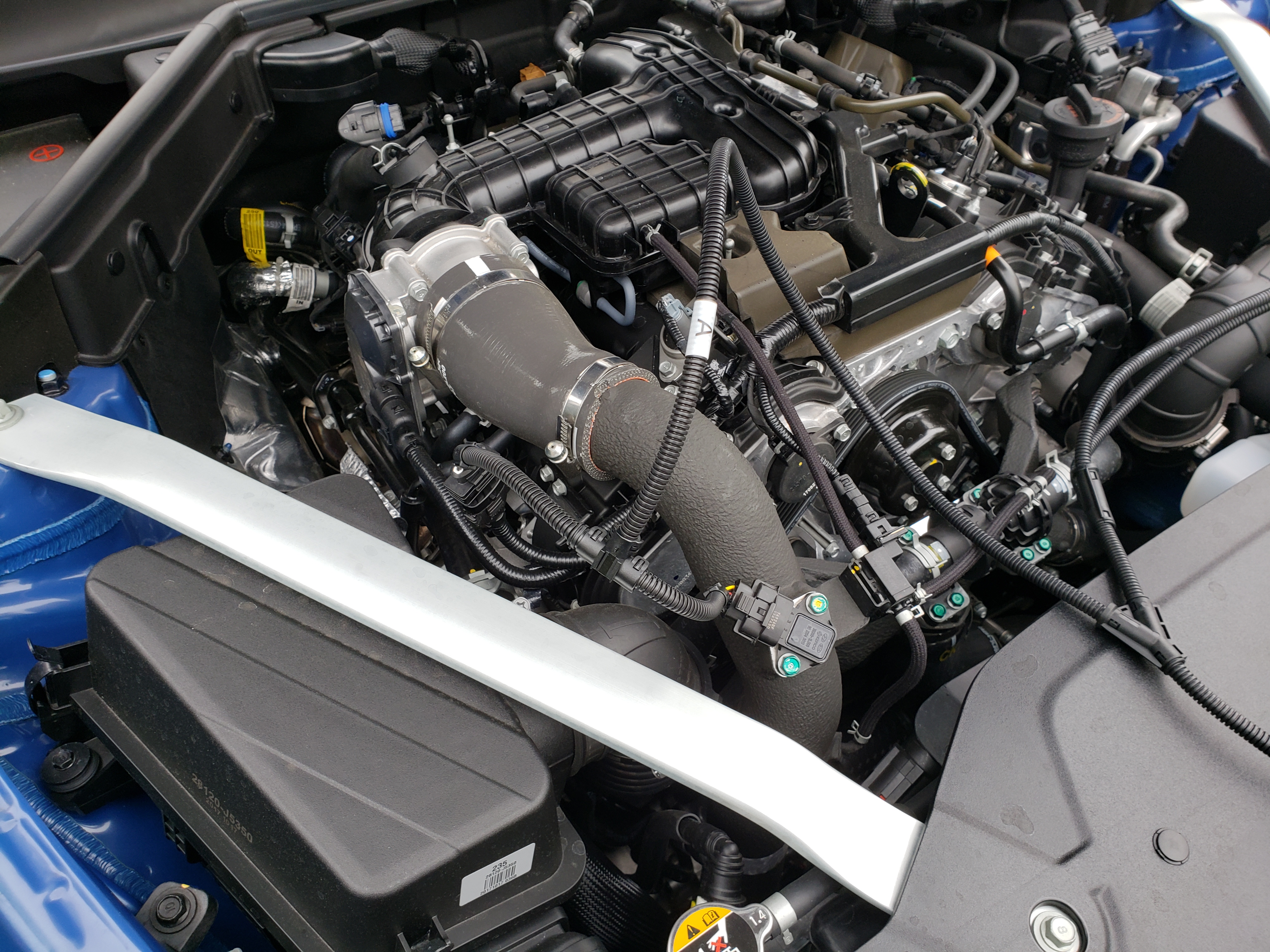

Unlike the LAP3, the RaceChip connects the boost pressure sensor, the intake pressure sensor as well as the cam position sensor. There's a warning to not connect the cables backwards, but I found that to be near impossible as there's a tab on the connector that prevents that from happening. What is very possible, however, is connecting the cables to the wrong sensors. These cables are all labelled with A, B, or C, and it's labelled in the instructions which letter goes to which sensor, so it should be pretty easy.
This is the boost pressure sensor connection.
Intake Pressure sensor connection.
Cam Position Sensor connection. This is by far the hardest sensor to actually connect to, given that it's nestled between several tubes. Still, installation was relatively easy.
I used several zipties to bundle cables together so they weren't jostling around, but not too tight. I routed the RaceChip connections as shown in the document - inbetween a gap leading to the left side of the engine bay near the passenger. The RaceChip connection seems better than the LAP3 connector - much easier to attach and remove, and watertight, whereas I wasn't sure the connection to the LAP3 was watertight.
