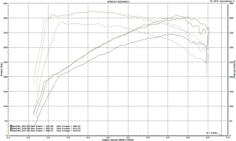

We have been busy in the shop the past month and we are trying to plug away at the Stinger as we can. Here is a mock up of our Primary cat deletes. We will be installing these along with our downpipes when they are finished to get some dyno and sound results.

What's that little tube coming out near the top of the left black pipe?
Here is a little update! We now have the Primary cat deletes on the car and our downpipes. Here are pics and a video! Dyno results will be coming today.

I think it does also. We just did some dyno pulls with everything on the car and it sounded awesome and make great power! We will be posting dyno sheets and videos up tomorrow but I believe the most it made was 408whp!
