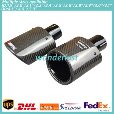

Well the stock exhaust rings dont allow the sound to exit outside of the bumper. The sound basically bounces back into the empty hatch area of the stinger and it acts like a boombox so to say. Once you use tips that extend outside the drone is much reduced and it helps even with the sound a little.
When i did a muffler delete using stock exhaust rings i could not tolerate the drone even for 1 day. It was absolutely unbearable. There are some nice exhaust tips i use from ebay that fit the 2022+ stingers well.
These are tips i got. You can change the inlet and outlet size plus they have to be oval shape to fit better.
Which size did you buy, did the tips fit cleanly without any trimming? I have a 2022 Stinger.
I got 2.25 inch inlet and 4.5 inch outlet. Fits nicely and won't rub or hit the sides. You can probably fit 5 inch but it will might rub. When I tried them on it was definitely going to rub so you might have to trim the sides a bit.
Here is a picture of my current ones. I am switching to the mbrp pro active so I already have ordered the 2.5 inch inlet and 4.5 inch outlet sizes. But yea they look pretty darn good and they are great quality. No fading or decoloration issues.
They look great, thanks!
To clarify, this fit is on a 22' with the stock catback? Also, Ebay only shows sizes in metric, did you get the 2.2" (57mm)? Thanks.
Yes the size is 2.2" 57mm inlet but this is for the borla catback. Not the stock catback.
What I gathered from this post here, the stock catback inlet diameter is 2.0" (51mm):
You will have to remove those exhaust rings to fit the tips. Kind of a pain but it will look great. Also most definitely helps with drone issues so that the sound doesnt bounce back into the rear bumper which the stock exhaust rings will do. The stock piping doesn't extend outside. Plus would look kind of weird if you do extend them further out.
