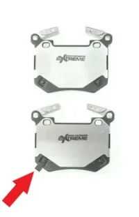

New Powerstop Z26 brake pads for the Brembos are marked "R" and "L" on the tabs. Is there a specific orientation for installation? Can't find any information.
The pads sit nearly vertical, so it's more Up and Down then Left and Right. Hmmm\
Thanks.
I don't think it matters, I would put the one with the metal wear squealer facing the outside of the wheel though.
You mean this?

Oh, I do. It's just I get this clunk noise when I change direction and first brake and I'm trying to eliminate any potential errors. For example, I pull into a parking spot. When I back out of the spot and brake, clunk. When I pull forward and brake, clunk. After that, nothing. I used the Powerstop backing plates, so now I'm mostly down to I should have used the OEM backing plates or I should have bled my brake system (which kinda seems obvious now...)

I didn't compare pads when I installed them, but the Powerstop clips are shorter. Maybe the new clips are allowing the pads to move...
I've been re using my pins and the clip, I just clean them with brake cleaner and a wire brush. I'm assuming the pins fit the pads, so if there's a bit of variation that would make sense. But I have the clunk when reversing as well. There's silver shims on the back of the pad that come off the OEM ones, did you transfer them to the new ones?
No, I used the complete Powerstop kit, clips, pins, plates and paste. Just kept the OEM parts for spares. I did take the plates off the OEM pads and kept them too.

the only "fix" is to replace the pads with better fitting pads - if the click when changing direction bothers you.
