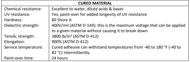

I broke 1 of mine 4 years ago. Been holding fine since I glued it back on with some marine goop.
