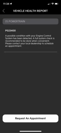

Hey guys was just driving home from work last night and all of a sudden got the engine light and this code. I have injen cai ark mid pipes and borla catback and hks blow off valves. Anyone get this code and if so what was the diagnosis. Is the dealer gonna try to claim these parts caused this? 2022 with 3300 miles….

Were you just driving along or were you putting your foot into it? How long have you had the mid-pipes on? No JB4?

About 15 min and i came off highway around bend and gave it some gas is comfort mode… no jb4 dealer said code was in history already cleared itself and no issues saying just from the cold air. Mid pipes on for about a month or so
