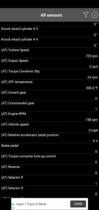

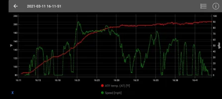

I have an OBDLink MX bluetooth adapter and I've looked for an app that can read ATF temperature in the Stinger. I previously tried Torque, Advanced EX for Kia, and others. None of them could read ATF temp.
I finally found an app named Car Scanner ELM OBD2 that seems to correctly read ATF temperature for the 2.0T. This app even has presets for the 2.0T.
If you know of other free OBD2 apps that can read ATF temperature in the Stinger, post them here.
The 2.0T ATF temp seems to range from around 200F to 210F in 53F weather.
