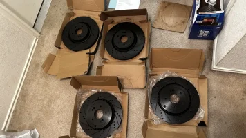

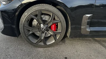

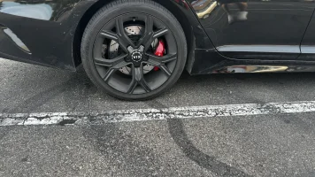

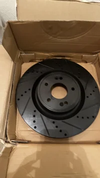

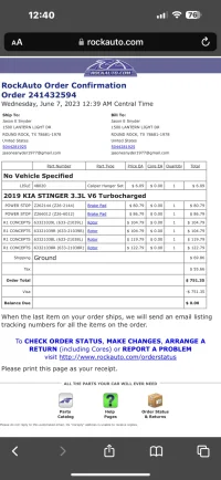

Just installed R1 Concepts black, cross-drilled and slotted rotors with Powerstop Z26 pads front and back. Completed the “bed-in” process as stated by Powerstop and I have zero complaints. The shake from stock pad/rotor combo everyone eventually experiences is gone. This is by far the easiest brake job I’ve ever. 2 hrs from start to finish because I had to wipe the brembos down. The pads come with new hardware and lube. I got it all from Rockauto for $750 shipped. They had everything in stock. Ordered Wed and showed up Sat evening. Everything came correct. Not trying to be a ad-boy for R/A, but y’all I’m really pleased. I can post part numbers if anyone needs them.

You may want to edit out your name/address/email from the receipt....

FWIW, it's not good when the drilled holes are lined up circumferentially like that. You can already see circular grooves getting worn from 1 hole to the next. That reduces brake effectiveness over time, as your brake pads and rotors will be worn unevenly and create repeating temperature gradient across the rotor. I'm no a fan of drilled rotors, but good ones should at least position the holes strategically so they are interspersed and not lined up perfectly around the rotor.
