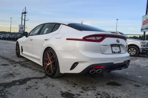

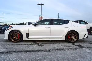

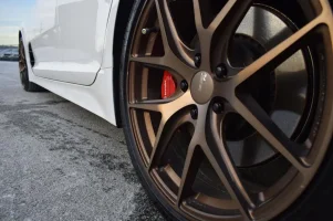

Here's some picture of Fast FC04 in 19" 8.5 / 9.5 ET35 . The car is lowerred but it give you an idea. Good luck with your research.
Another with 8.5 ET32 (3mm more out) and 9.5 ET40 (5mm more in)

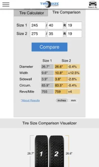

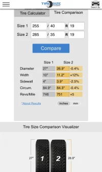

Would 245/40/19 and 275/35/19 be better for AWD since it’s closer circumference overall compared to 285/35/19? Also, 255/40/19 seem to be better in the front with 285 rear, but I’m not sure if it would be ideal to have 255 with 8.5” wheels? Thoughts?

I would avoid going too wide on the front. Yes 275/35/19 is perfect but I wouldn’t be worried with 285/35 since you will burn the rear faster anyway...
My experience with AWD comes from the Celica AllTrac (GT4 outside the USA) and the Subaru WRX. It has pretty much always been the recommended route to have all 4 wheels/tires be the same. So whichever route you go, I would match the front to the rear. There is nothing to be lost really. Grip=Good.
