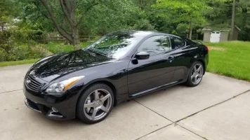

lol, i alternate ... black, get pissed off with it, then silver or gray, then black ... rinse and repeat. at least graphene and ceramic spray coatings help out a bit now. the G37xS coupe i had before i needed a break with the Q60 ... those Forgestar wheels might go on the Stinger ... 20170522_145918.webp
