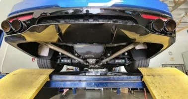

Muffler delete is definitely cheaper than spending $1000 on any exhaust and even then they do not sound all that. I cut off my muffler, added tips, and put some sound deafening pads in the spare tire area and my drone is pretty tame. I spent no more than $300.
I have just refitted my stock primary dump pipes and secondary cats after 2yr's but have a TORK Motorport resonator tube, into a stock bimodal exhaust and i think it sounds wicked and it doesn't feel any slower than when i was catless, except now i don't blow oil smoke on deceleration !!
I did a muffler delete during summer of Covid. Coming up on 5 years, and still like it, a lot.
I only replaced the section you can UNBOLT from the rear of the exhaust.
The SUPER important part is that you have TIPS welded to your exhaust. Do NOT use the factory tips. I have owned cars with drone, this is NOT one of them. I call people all the time in my car, and I can hear them just fine.
For the price of tips (which you can reuse on that fancy MBRP exhaust) and $150 to have some pipes welded up, I say you should try it out first.

Stock Cats /Stock Secondaries /Tork Resonator and the bottom cut out of std mufflers lol
