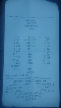

I been able to get my Stinger from a 13.9 I ran stock to 11.9 with minimal mods.
Just last year I ran at the track I ran a 12.5 was my best time. I only had JB4 (Map 2 with old firmware), SSR downpipes, muffler deletes with DIY intakes.
Earlier this year I was able to run an astonishing 11.9 ¼ time. The only changes made were using some E30 fuel mix, using launch control, lowering the psi on my tires and using Map 5 on the JB4. This was accomplished on a full weight Stinger.

Below is the current ¼ Track times for reference. (If you want your time to be posted on the Official ¼ list you need to post your time on the official ¼ mile thread, this is used for reference only based on the discussion to improve your ¼ mile times)
1/4 Drag strip Top 15 times (Official Track List)
1/4 mile time, speed, 1/8 mile time, speed, 60
1. 11.86 @ 117.16, @Tonkabob, 7.67 @ 93.53, 1.84
GT2 AWD, Tork ECU tune, Ark catback, JT intake, Ultimate FMIC, SSR midpipe, wheels. E20
2. 11.94 @ 118.11, @STINGER, 7.77 @ 92.99, 1.89
RWD, JB4 map 3, WMI, VT Snorkel, K&N Drop ins, High flow CAT, JunBL mid EVC cat back
3. 11.974 @117.69, @Angel, 7.79@93.39, 1.88
AWD, JB4 Map 5, AP Intakes, SSR Downpipes, SSR Muffler Deletes, Tork OCC.
4. 11.975 @ 118.98, @GetStung 7.825 @ 93.67, 1.87
AWD, JB4 Map8, WMI, Secondary CAT bypass, Borla catback, Injen intake 93 octane + E85, E30
5. 11.98 @118.96, @TorkMe, 7.84 @94.03, 1.95
GT RWD, Tork ECU tune, Tork intake, muffler delete, no cats, fmic. 92 Octane
6. 12.022 @ 117.42, @Stinger33 7.82 @ 92.85, 1.94
RWD, JB4 map6, JT intake, JT exhaust, Throttle body, GFB BOV
7. 12.05 @ 116.58, @Kato_the_kia_stinger 7.87 @93.02, 1.93
AWD, JB4 map8, K&N intake, VT snorkel, WMI, 93 octane
8. 12.07 @ 116.73, @Crewdawg130, 7.85 @92.65, 1.90
GT2 RWD, JB4 map3, intake, Ultimate HFC primary and secondary, FMIC, Drag radials. 93 octane
9. 12.09 @ 114.83, Miguel P, 7.80 @ 91.61, 1.86
GT2 AWD, Tork ECU Stage 1, CX CAI, CX FMIC, muffler delete.
10. 12.13 @116.78, Jesse P turbokits.com, 7.89@ 91.51, 1.87
AWD, Lap3 pro mode 2 (old mode 3), Intake, FMIC, no cats, 93 octane.
11. 12.13 @116.16, @DaBears4Lyfe, 7.89 @ 91.61, 1.87
RWD, JB4 MAP 8, CX Racing Intakes, BMS WMI, Lap 3 Primary Downpipesw/ HFC, X Force Exhaust w/ EVC Closed, GFB BOV, VT Snorkel, Sixth OCC
12. 12.17 @ 116 Michael Locke, 7.95 @ 91.93, 1.95
AWD, Lap3 pro Mode 2, Injen Intake, lap3 down, SSR Mid, 91 + E30
13. 12.23 @ 116.26, @ScottyCole, 7.98 @91.03, 1.95
GT1 AWD, Lap3 Pro, K&N Intakes, UP HFC down/mid, Borla Catback, 93 octane + E85
14. 12.25 @ 116.96, Robb Banaga, 8.06@92.51, 2.06
RWD, Lap3 Pro map 2, Ingen Intakes. 91 + E85, E37
