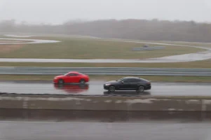

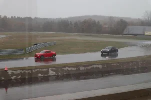

I live in Canada, I think I know AWD doesn't help you stop, but a good set of tires do, that is why I mentioned the caveat on fresh tires. I cant say how the MPS4 will handle once worn. Anyway some photos from that track day.
I guess Stinger > than BMW 5 series. And Audi TT . IMG-20181029-WA0003.webp IMG-20181029-WA0004.webp
