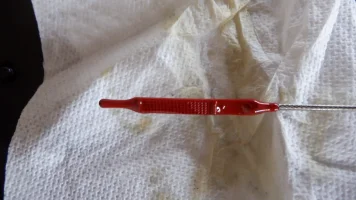

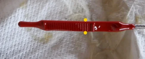

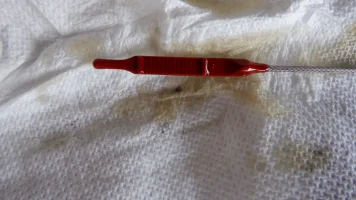

FWIW Have been running 5W-20 Royal Purple for almost 8 years now and never had an issue. Live in Arizona where it's hot, so if in a very cold climate this might not be ideal.
Always take out 8 quarts and put 8 quarts in. I think Kia suggests 7.29 quarts but have a secondary oil radiator so add a bit more to compensate for the cooler / lines. Oil has always been to the top of the stick, even since new from the dealer in 2018 before any mods.
5w30 you mean?
5w30 you mean?
Nope, I mean Royal Purple 5W20, and changed pretty regularly. Maybe not ideal for a daily driver, and probably not for really cold climates.
While it's probably not hurting anything, going down to 20 weight would be better suited to colder climates. For hot Arizona summers, if anything you'd want to go the other way, to a heavier 40 weight.
If you're not pushing the car hard, and have a secondary oil cooler, you're probably well within design temps for 20, 30, or 40 weight. But it might be worth trying Royal Purple's 5w30 or 0w30 next change, and see if it idles any quieter.
What was the motivation behind using a thinner oil (than say 5w30)?
