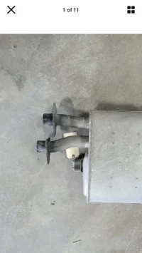

Finally, Kia along with different aftermarket systems I have looked at include this Z shaped plate (look at stock muffler in picture) at the end of the system. I wonder why they all use it and MBRP does not. Is it for aesthetics so you cannot see inside/behind exhaust tip or a condensation drip edge?

I didn’t add anything to negate drone. I imagine those plates are all to help negate drone. If you’re concerned about it get some exhaust wrap and wrap the tips before putting the exhaust on. Cheapest way to get rid of any resonance.

Look under your car from the back. Notice how the stock exhaust tips are not attached to the exhaust? They float inside the tips.
When you put a louder exhaust on the sound resonates under the car rather than out the back because the tips are not connected to the exhaust.
Aftermarket tips fit snuggly to the exhaust and force the exhaust to exit the back of the car so that it doesn’t resonate underneath and cause drone.

It does not come with independent exhaust tips because the stock solution has BUMPER TIPS where a seperate Y pipe goes inside them and then has the circle around them to create the visual effect that it can be seen that its not a real tip as well as get rid of a bit of drone.
For drone purposes the best solution is seperate tips (Aliexpress Akrapovic ones are the best looking) and then sound deadening in the trunk. The metal circles around the exhaust pipes actually have very little effect on drone compared to real tips & sound deadening, tested it on my custom solution.
I for one am glad they didn't weld on a plate like the OEM exhaust. That way I didn't have to cut the damn thing off to install my CF tips.

None of the aftermarket exhausts for the Stinger come with exhaust tips because the car already has them.

You sure can run the exhaust with the oem tips but be aware that you will hear (feel) some drone sounds ...
as for the flat plate you were referring to, you will reuse that plate :)
