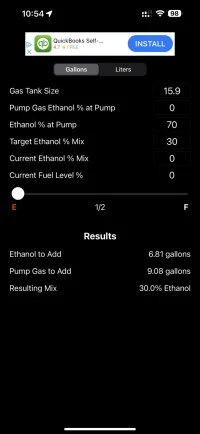

Then 6.8 gals
Then 6.8 gals

15.9 gal fuel tank
15.9 gal fuel tank
