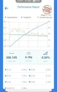

Definitely a fun and worthwhile upgrade. Here’s from when I had intakes, secondary downpipes, catback and the Lozic tcu. No ecu, no piggyback and 1/4 tank of 93 with my Awd Stinger GT.
Then I added the Lap3 stage 1.5 ecu back around December and got this. I believe a perfect run with a better mix of e30 i could cut a 3.3~ 0-60.BB502711-9AC3-4F9A-9513-BF3F200F793F.jpeg
View attachment 69235View attachment 69236
Then I added the Lap3 stage 1.5 ecu back around December and got this. I believe a perfect run with a better mix of e30 i could cut a 3.3~ 0-60.View attachment 69237
