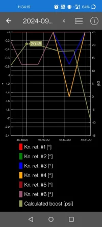

Yes. I use a 96 octane gas blend. The Lap3 tune timing functions a little differently but I still get some correction, not much though (between .75 degrees and 1.5 degrees of timing corrections). The only way to have zero is by going meth injection. With my exhaust setup, boost is around 19 to 22 psi depending on outside conditions and I've observed timing at 11 to 13 degrees at those boost levels.

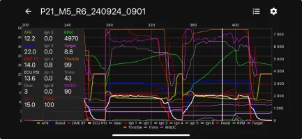

Ok. Nice. My logs, BMS BEF, JB4 map 5 and 6, EWG connectors, HKS spark plugs and BMS intakes. The price for Lozic is ridiculous. With JB4 you known what your engine is doing.
BMS BEF + JB4 gives you flexibility. It requires Ek1, but you can use it as a diagnostic tool, to reset your adaptive and tune TCU.
For daily driving, I use map 4, when in need I go to map 5 or 6. It gives you the possibility to go with a lower map when you have to fill it with fuel of poor quality.

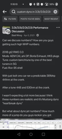

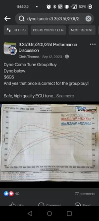

How could I go and get a custom tune done? Haven’t heard anyone do that?
I've seen quite a few owners have custom tunes on the 3.3t/3.5t/2.0t/2.5t performance Facebook group. Not all shops with a Dyno can tune KDM cars so you'll have to ask around your area.

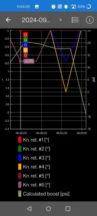

What my timing corrections (cylinder retard) looks like at high boost levels

It's not like you have problems with JB4 map1, go for the ECU tune and get much more power. If you can, put your log file, map1 and map0 (JB disabled).
These tunes, especially for higher boosts use some ignition advancing, sometimes very aggressive. You will see much more corrections on your Ign2-6.
Yours looks really good, got some stuff to think about i guess. Evrything was great when i was on e30 just my fuel pump got mad I think i had to much e in my system.
