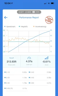

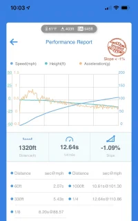

Here are the numbers I am getting basically stock. I don’t have any sort of tune at all. No meth. No aftermarket intake, exhaust, or intercooler. Just basically the AirScoops Snorkels.
View attachment 53473View attachment 53474
I would consider your 0-60 to be quite good for RWD without a tune as I haven’t seen anyone in the 4.3 range. Thanks for the info.
