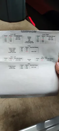

I have ArkGT-F springs and my front left camber is out of spec, the rest are OK.
The stinger doesn't have camber adjustment, so expect a little uneven wear. Eibach may me a bit worse since the drop is a little lower.
