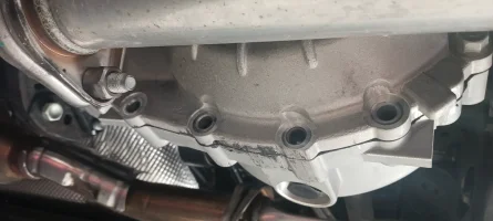

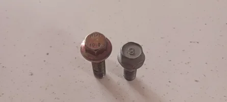

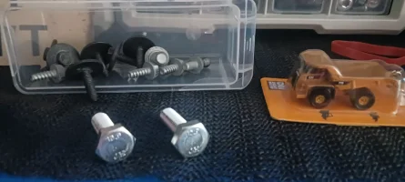

In @BIG-D's pictures below, the ones on the car are marked with an 8, but the ones in the bracket on the desk look like they might have a double digit metric class marking...maybe he can confirm.

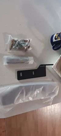

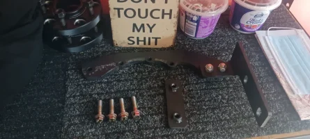

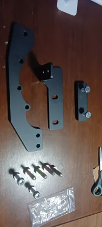

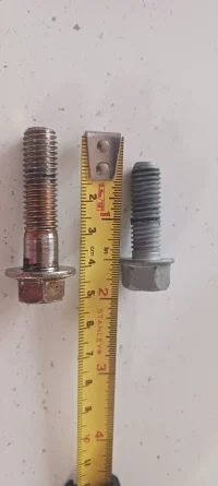

Here ya go brother, the bolts supplied are 1/2' longer in the shank the thread is the same count...
Here ya go Scott the bolts supplied are 1/2' longer in the shank the thread is the same count...
And obviously grade 10.9, which after a quick browse is closer to SAE grade 8.

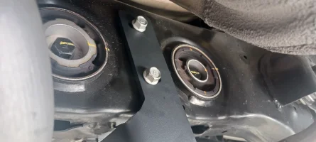

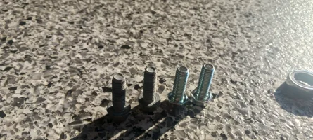

Decided to remove mine while I was under there... my diff bushes look like new haha.
I reused 2 of the original diff bolts to attach the rear bracket to the cradle I didn't trust the 2 shiny ones supplied with the kit would have been strong enough ?

I've noticed a bunch of the Kia's bolts have an 8 stamped on them. I don't think that's a standard marking for either SAE grade 8 (which it would be odd for them to use as Koreans), or a metric grade (which should be follow the #.# convention).
But I can't imagine what else it would be. If it's metric 8.8 then those 10.9s are something like 1/3 stronger, and if it's SAE grade 8 then your metric 10.9 is roughly equivalent, I think.
