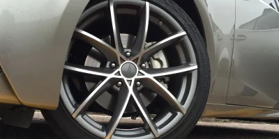

Thanks Steve...I assume that's your own garage. I like that storage rack...I could make something like that work here. Those rims look great...any concerns about speedo/odo...or is there a setting you can swap out for wheel size? (alternately, did you just get taller tires to make up for it? It looks like you may have)
Got these rims at Discount Tire for $96 each plus a $100 rebate. Liquid metal instinct. Ceramic coated them this week. Waiting on the tires but might go with Goodyear Weather Ready.
Are those 18 inch wheels? They look nice. Do you have a GT or non-GT Stinger?
Yes, the different sidewall/profile of the tires (225/45 R18) compensates for the rim change - the circumference is within a tenth or two (of an inch) of that on the stock 19's, so no issue with the speedometer at all. Bought the tire rack on sale for 29 dollars - smoking deal! :thumbup:
