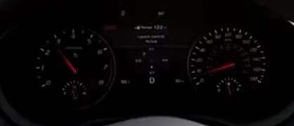

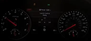

screen grabs from someones video
First one says ready
Second one says active
