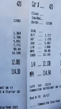

Hit up Great Lakes Dragaway yesterday for my second time out with this car. Only made 3 passes since there were around 250 cars. 12.10, 12.08 and 12.09. I think if I would have waited longer before my second run, the 12.08, I could have gotten in the 11s since IAT was at 132 at the start of the run. 60' times were pretty good, 1.7-1.72 using a switch in place of the stop lamp fuse. There was another Stinger up there, black GT AWD with Wisconsin plates but I didn't get a chance to talk to him.
Mods are JB4 with fuel and EWG wires, HKS plugs gapped to .022, K&N Typhoon intakes, Ark secondary DP, BMS OCC, BMS intercooler, VT air scoops and stop lamp fuse switch.20211017_114748.webp

If you just take the fuse out will it work the same way? Do you use launch control with it like this or just mash the gas from a dig?
Just pulling it works but it's easier to flip a switch before staging. Don't use launch control and definitely don't mash it, you gotta watch how much boost you're getting as you ease the throttle and launch when you have the amount you want. Which is why my reaction times were terrible.
