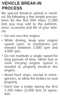

Well, here is what the Kia Stinger Owner's Manual says:
VEHICLE BREAK-IN PROCESS
No special break-in period is needed. By following a few simple precautions for the first 600 miles (1,000 km) you may add to the performance, economy and life of your vehicle.
• Do not race the engine.
• While driving, keep your engine speed (rpm, or revolutions per minute) between 2,000 rpm and
4,000 rpm.
• Do not maintain a single speed for long periods of time, either fast or slow. Varying engine speed is needed to properly break-in the engine.
• Avoid hard stops, except in emergencies, to allow the brakes to seat properly.
• Don't tow a trailer during the first 1,200 miles (2,000 km) of operation
So this is what Kia says - it looks rather generic, and I am mildly amused that the first part says that there is no special break-in period required, but then goes on to list five things that may "...add to the performance, economy and life of your vehicle."
4,000 rpm.
