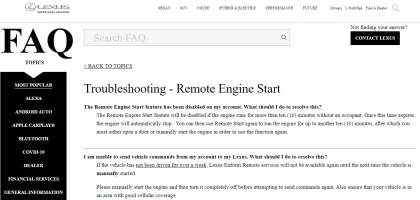

I wonder after so many hours the computer shuts down to conserve battery power as it would be a drain on the battery after that many hours of not being run.. The cheaper remote start options still works since that would just use normal radio signals vs needing to power the cellular modem...
probably the same reason lexus does the same? I remember trying to figure out why my coworkers lexus remote start didn't work after she came back from a vacation.
