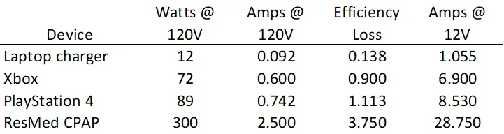

Not sure what you plan to run off of this inverter, but here is a quick cheat sheet on some power loads (Keep in mind Amps are per hour):

The stock battery is 80 Ah, so if trying to maintain above 12.1 volts to ensure the car starts, you'll want to make sure you use no more than ~20 Amps of energy. Also consider that the alternator is sized to power the vehicle's electronics and replenish discharge used when cranking. Adding an inverter creates an environment where the alternator will become more of a battery charger. In reality, you should increase the alternator capacity AND cabling so it can carry the additional capacity. Your alternator will get hot enough to fry an egg otherwise.
