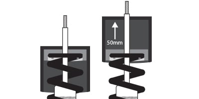

I'm still fantasizing about the 911 Dakar that can lift the entire body on command for extra ground clearance. I've always wanted something like that for the snow and logging roads, but I'd like to keep the stock adaptive suspension if at all possible.

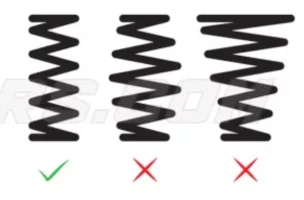

I recently found these air cups, but they explicitly state they only work with linear springs. Is something like possible for the OEM springs, or do I need to go aftermarket to make this possible? In which case a straight up air suspension setup might be better? I know very little about suspensions at this point.
These are your stock springs - shape.
So, no
