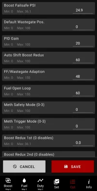

Can you post your jb4 settings page? Double check to make sure default wastegate pos is set to 0. I am assuming you did not have this issue until you installed jb4? Since map 0 does not cause this overboost limp mode issue it makes me think its some setting in jb4.
I dealt with overboost issues as well until I got jb4 with ewg wires and lowered wastegate adaptations to about 45 and always got nice clean logs.

Thank you for your reply! I have ff/Wastegate set to 30 (originally it was 50 until Terry told me to drop it), not 0. Unless there is another segment specifically labeled as “Wastegate”? I’m using the JB4 PRO app so the layout is a little different than the other app.
But correct, map 0 doesn’t trigger it. Just when I change to map 1 (haven’t tried map2 as I’d want to figure out this issue before going higher). But I definitely feel like it’s something I need to tweak in the JB4 pro app. I just have no idea what lol
Doh I am using the regular jb4 app. I think you probably need to as well. I know the jb4 pro bluetooth chip is the new thing out installed in recent jb4 kits sold but I am not sure about the jb4 pro app. Also I know there is no jb4 pro hardware kit out for stinger. It is only for very few vehicles.

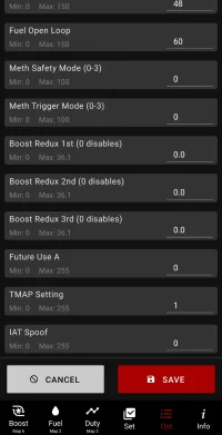

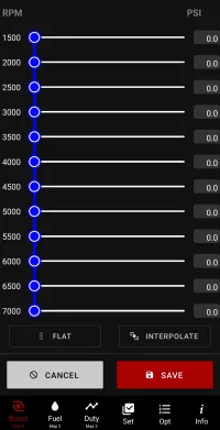

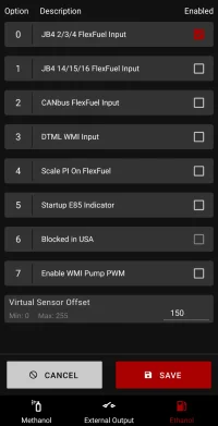

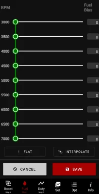

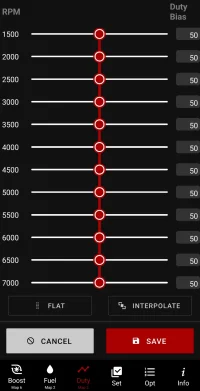

Generally the wategate adaptions doesn't need to be that low unless you running high flows/catless primaries. The other settings you mentioned seem fine they are the same on mine. There should be an options setting somewhere in jb4. Make sure fuel bias is all set to 0 as well. Here are my settings before I went BEF. After bef we disabled the fuel wires and also physically removed them put it back to stock. Ewg wires are there but are not doing anything and the ecu bef overwrites them anyway. Learned this when we were doing KJT bef.
