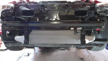

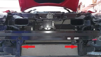

Many of the Australian delivered Stingers have these front supports that brace a support lower down for the front spoiler.
Because of these, almost every Intercooler / kit available will NOT be a direct fit !!
Yes, with a grinder etc, you can make anything fit but there is no such thing as a DIRECT fit for this variation that I know of.
I've been doing my homework and some trials and it's been something of a rollercoaster ride.
I did get 1 intercooler to fit but it still needed grinding and the final result is acceptable but not perfect.
The only reason I went ahead with it is because the grinding was minimal and I really wanted something better than the OEM unit.
Any way, be warned, do your homework and good luck !
