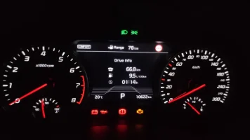

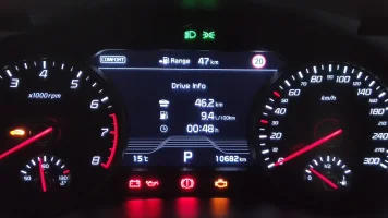

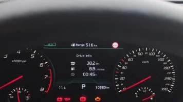

Since I modified the set up "reset fuel consumption after refueling" to not reset I have seen changes in the average fuel consumption. Now I see lower numbers about 9-10 liters/100 km.
It seems weird. My car has almost 11000 Kms now. I do not know if after 10K and a 1000 kms long trip I did the consumption has been decreased.
View attachment 39336 View attachment 39337 View attachment 39338
