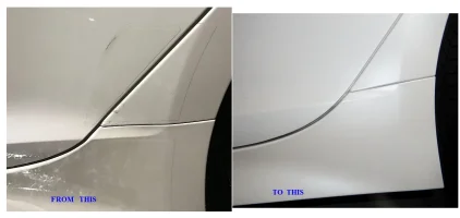

Those unsightly pseudo stone protection stick on patches just forward of the rear wheels can easily be removed as follows -
1) Grab partners hair dryer (or your own) set on full blast and gently peel off. If too hot for
your fingers it's too hot for the job.
2) Remove residual glue with eucalyptus oil.
3) Remove oil with methylated spirit or ethanol.
4) Polish with whatever wax you use. I only use Pledge furniture polish.
No more ugly cheap patches to collect dirt and yellow with age, possibly changing the paint color too.
Voilà:
Left image courtesy of @Robs

Yep - no swirls or scratches. I only use car polish for really difficult to remove stuff and for super hard to remove I use Brasso but very carefully. This is from over 55 years of car ownership.

Why would you want to remove items on a car that protects the paintwork in vulnerable places.....I don’t get it, people are adding additional clear film to their cars for more protection.....just my opinion & everyone’s opinions differ, that’s what makes the world go round.
Thanks for the post. I will be removing mine before the ceramic coating next week.;)
My detailer removes mine as:
1. Dirt was starting to accumulate around the edges and was very visible on a white car.
2. Wanted the ceramic coating applied on every painted surface
3. Added mud guards so the likelihood of debris kicked up by the front wheels and scouring the rear doors is minimized
4. Two small sections of plastic film is not going to prevent much chipping/scouring anyways
5. Seen many Porches which have huge protective film stuck on and have dried up, cracked and taken the paint along with the cracking

I don't think anyone's denying it adds shine - the discussion on the interweb was around longevity and paint protection Vs modern waxes and (non-furniture) polishes.

Good valid points....especially point 2.
Not a big fan of mud flaps on performance cars I never intend to go off sealed roads in one. Most Euro cars in the tropics dry up & crack they are built for cooler/cold climates without the strong sunlight we get here.
