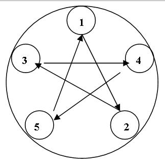

Break the lug nuts loose while the car is still on the ground to make things easier for you. Don't remove them, just break them loose to the point that once the car is jacked up you won't have issues getting them off. Remember to work in an opposing star pattern, not clockwise. This goes for removing and re-installing.
