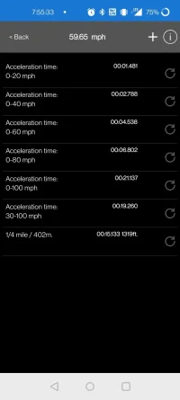

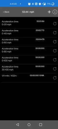

I've been playing around with my Bluetooth ODB2 scanner and doing some 0-60 launches. I turned off the GPS permissions so it's getting the speed from the car's speed sensors. I'm sure I reached the point where I need some wider tires since I'm still on stock wheels which are 225 front, and 255 rear.
Even though my fastest time was with launch control I wasn't satisfied with the amount of wheel spin I had. I tried a 2nd gear launch in manual mode and wasn't far off, so that may be my go-to method.
I plan on stepping up to 245 fronts and 275 rears, lightweight wheels, and a diff brace. Hopefully, that helps my RWD Stinger put down the power. Also, I'm not sure if I want a TCU tune.
How do you launch your car?

Sounds like I'm going to have to find the sweet spot when rolling on the throttle from 0.
