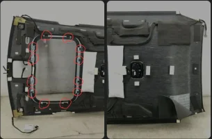

In an effort to figure out why my headliner and B pillar are noisy, I discovered that not only where 2 of the 4 foam pieces free loose on my headliner, but I am also missing at least 2 of the black clips in front that hold it in place (I have not even checked if missing any from the side or rear)
Can someone help me find this part number
I have looked through the diagrams on the Kia parts sites and there is no mention of these clips, the only clips it lists (853993k500) is not the right part at all
Here is a pic of a back of the headliner with the clips in question circled:
here is some pictures I took of just the clips
For reference here is a pic of the 853993k500 clip that kia parts sites list (clearly not the right clip):

Thanks, got some ordered.

I actually found that clip in my searching ... but whichever kia parts site I was at did not say Stinger. It listed Sportage and several others, but no Stinger; so I had assumed that wasn't the right one.
When I went to order it, the pages the dealership had to look at where completely different and took him right to it.
