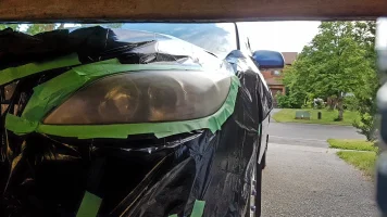

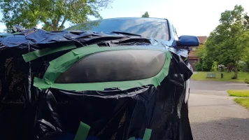

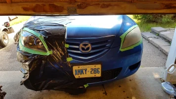

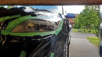

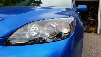

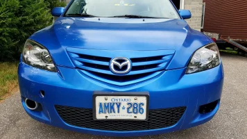

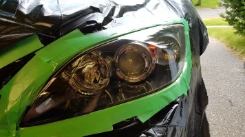

On my 2004 Mazda 3, when it was 14 years old, in 2018 I painted the headlights with some cheap rattlecan acrylic clear coat - UV resistant standard automotive stuff. I only kept the car for a year after that, so it lasted at least a year and looked great as the car left on a tow truck to the scrap yard after ~480,000 kms.
Results speak for themselves - and it still looked excellent the day I sold it to a scrap yard replaced with my Stinger.
Wet sanded with 240 grit - friends said I should use 600, but I said, nah, it'll be fine, and I didn't have any on hand.

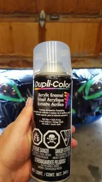

The rattle can I used.
Sprayed super light coats
Half of coat #2 in the next pic!
4 - 5 extra light coats, with the final coat being as thick as possible without runs.
20181104_170515-01.webp20160612_190503.webp20160612_190526.webp20181104_170535-01.webp20160612_190537.webp
I was quite satisfied with the results.

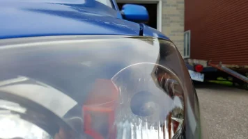

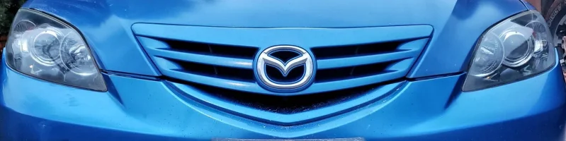

In my experience, after the original OEM UV coating is worn off, polishing only lasts a few months at a time. The yellowing always returned quickly after multiple polishing attempts.
This final painting technique I used lasted much longer for me, but after a year I scrapped the car, so I don't know how many years it would have lasted.
This is 11 months after painting the headlights - obviously this image isn't focusing on the headlights, but you can see they are still pretty decent.

If you are going to spray CLEARCOAT it has to be 2k. otherwise to make it easier, I would just polish it out and PPF.
