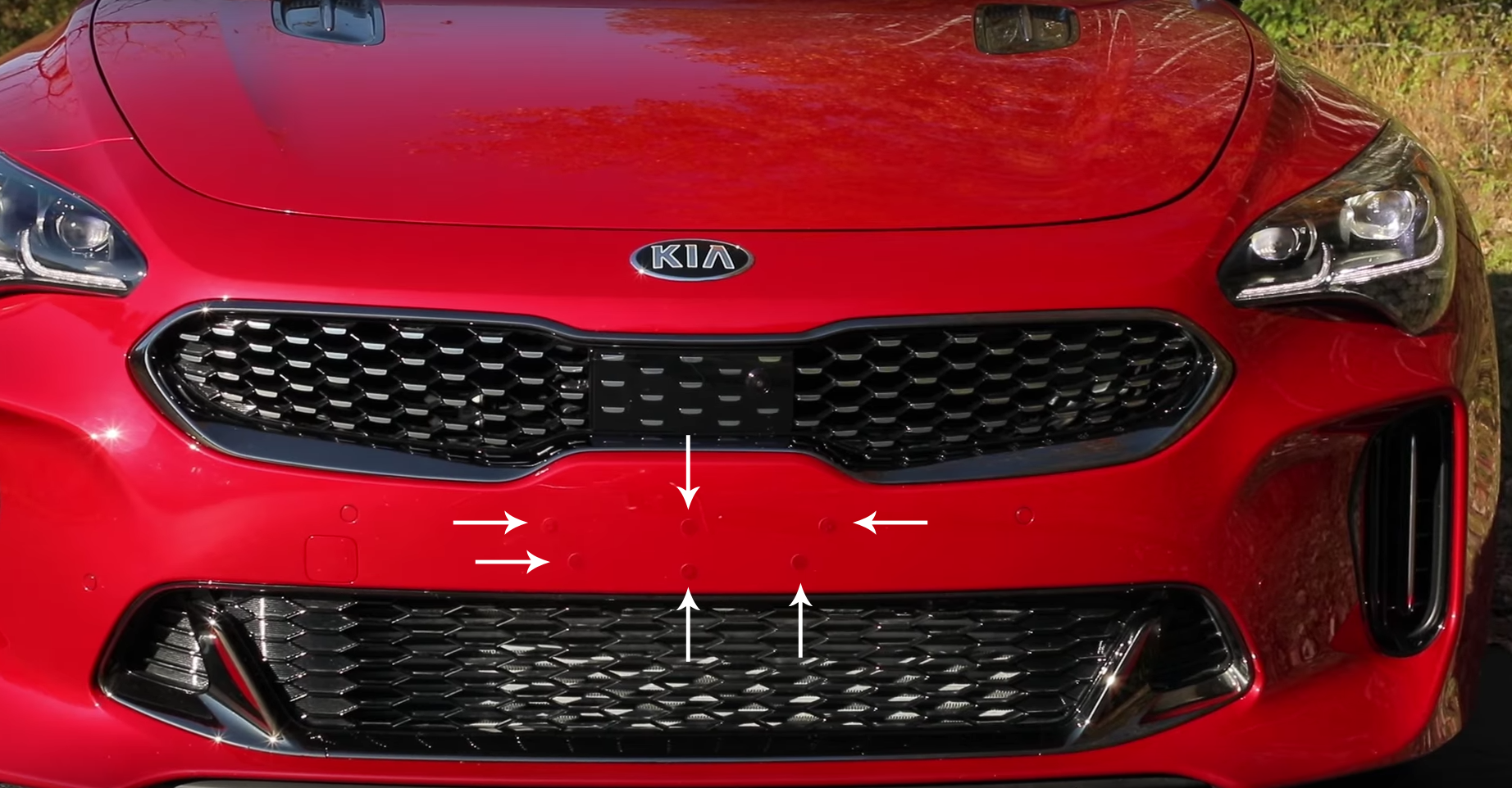

I suspect he is referring to the bottom grill, on the sides (see image below)
