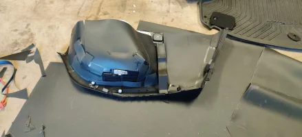

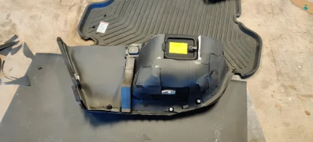

Definitely put deadener on the wheelwells. Anything to lessen the vibrations in the sheetmetal should help.
As byebyeSTI said, resonix is by far the best, but quite expensive. I used Dynamat Xtreme.
MLV is a sound blocker, but it needs as near to 100% coverage as possible. One good analogy I read is to imagine your neighbor is mowing their lawn outside. If your windows are closed then most of the sound is blocked, but crack the window even a tiny bit and it gets much louder.

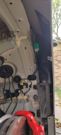

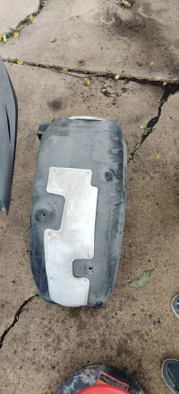

The front wheel liners have a giant notch around the suspension, so frankly I have my doubts that MLV will do anything here, but I guess there's no harm in trying. The rears are much easier to get good coverage.
There's also a giant cavity behind the driver side wheelwell, definitely stuff it with something.
Honestly the best thing would be to use 3M acoustic thinsulate (not the stuff in your jacket) instead of thermozyte. It's expensive but has better noise reduction coefficient. The stock wheelwells actually have small patches of it already. Most auto OEMs use it, so I'm considering just going to a junkyard and grabbing some from the "quiet" cars like Lexus/Mercedes/etc. There's likely a bunch behind the door cards and above the headliner.
Notice in the graph below how quickly the performance drops in lower frequencies. Absorbing bass takes lots of space or lots of mass, it's up to you how much weight and money you want to throw into this project. As a point of reference, my MBRP exhaust drone is about 150hz.
Even though my tires still have most of that low frequency roar, killing the whine was a huge QOL improvement.
ps: I also added MLV to the interior wheelwell liners.

FWIW, the OEM rear liner has some kind of thinsulate-like material from the factory.
