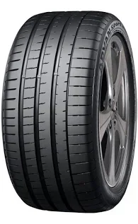

I changed out the four Michelin Pilot Sport 4 that came with the vehicle.
The front tyres shredded at 20,000kms. Michelin offered no explanation for this.
I put it down to poor compound during manufacture and wont let a Michelin tyre near my car again
I put Yokohama Advan Sport on. Significantly more expensive. Better specs. Better handling. Better everything except price.
