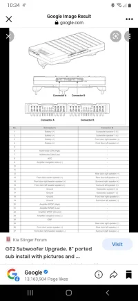

Can I ask where you find the wire diagram? Is it comprehensive enough for a remote start install?
I found it on this site somewhere. It was just for the amplifier pinout. The information you are looking for exists, just need someone who can access it.

I have a JBL BASS PRO HUB. I have Blue Remote wire tapped into the #8 ACC WIRE on the Blue Connector side of the Stock amp coming from my JBL and it is NOT turning off my JBL at all when the car is off Anyone know why it is not turning it off?
