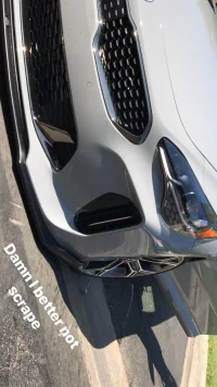

Might be closer to 7", but it's not terrible. I've pulled over sidewalks and stuff without damaging the front bumper. It doesn't seem to change much when loaded either. Took this picture yesterday, after unloading 4 people from my car. Didn't scrape at all, and I had barely 1/4" of clearance under the diffuser.
Wow, man that is close! Nice that it did not scrape...haha, only us car nuts can understand taking pictures like this!
even with a lip theres a small clearance. btw the hill was pretty steep and no i didn't scrape, had to go at a angel tho.
